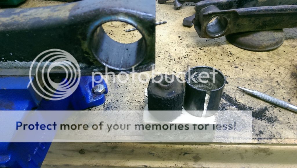

In between running around after family this weekend I got about two hours in the man cave.
After last week's efforts and resorting to kb for assistance I had another go on my own. I down-sized the drill bit for a neater job of taking out the rubber. I ensured, as best I could, that the cut was all the way through the metal outer bush. It still took a bit of bashing and the outside edges of the bush were denting rather than moving at first but it came out fairly easily and more or less intact. I had a quiet chuckle and felt more than a bit pleased with myself. While I was at it I got the U-clamp end and Castor Arm ball joints off the rusted tubes.
When removing the outer sleeve of bushes like this, it can be made very much easier by making two hacksaw cuts, at opposite sides to each other. The temptation is to make just one cut and then start walloping it - this tends to just make the cut sleeve bind in the housing. With two cuts, the sleeve tends to just fall out. Sorry if that was after the horse...
Discussion starter · #635 ·
Thanks Tom. I only have one left to go. That stratagem was actually discussed. Being blindly stupid I simply followed the EBS video which as far as I'd recalled made a single cut. I'll try it with that one! :thumbs:

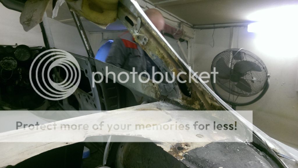

I had to take the rear screen for trial fit following the panel replacement
More welding inside C pillar
And another small piece in the footwell to sill
Fuel tank area
They aren't happy to have to use filler rather than New panels everywhere :paperbag: but tough. Only the roof and bonnet haven't needed some correction
