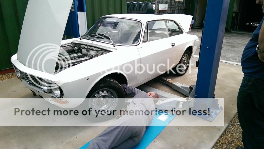

"Actually this is pretty good....some surface rust...."
Weeping steering box gasket the first thing not on my list...
Lots of encouragingly solid "thunks" as metal is tapped. After much scraping a 5p sized hole is found in the passenger footwell.
24,536 Posts
Discussion Starter #3 (Edited)
Bodies in the way, so looking through the back windows, rear floors sound, lifted the vinyl wheel arch covers, more prodding, more nodding.
Amazing. Even more solid this side. Sills were replaced to a good standard shortly before going off the road in 1984.

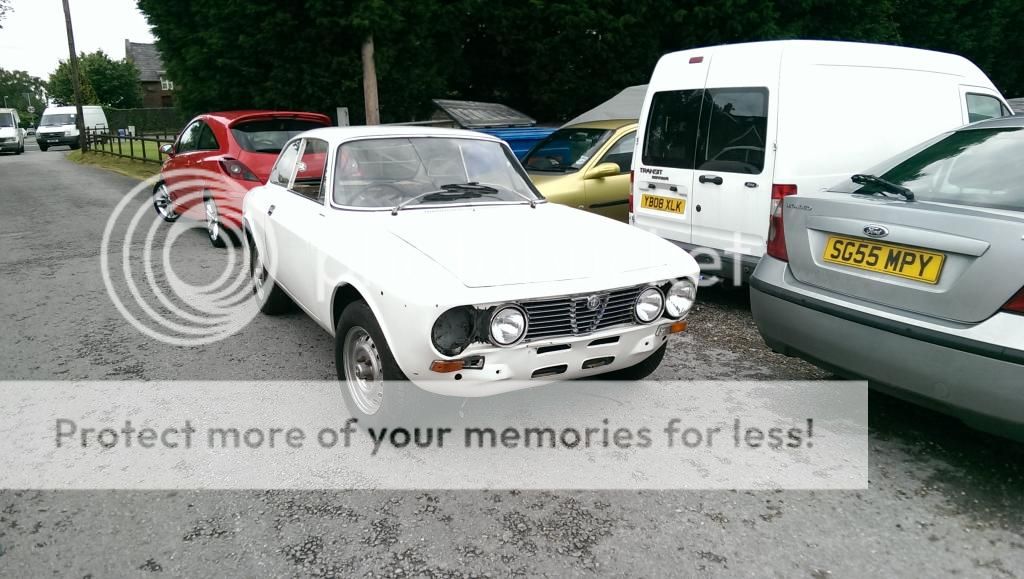

The car has been left with them. I've stepped off the ledge.
Next step. Detailed parts list. Engine and box will come out. Rolling chassis goes in a few weeks (they are busy) for soda or media blasting and Dinitrol treatment.
Still can't quite believe I've done it!

- what are they going to do to your car? It seems pretty solid overall. What needs doing?
- 9th pic down shows (i think) steering linkage-thingys. Do the Berties have a recirculating ball steering, rather than a rack and pinion system? Just an observation (and probably one I've got wrong :) )

G, yes it has a steering box.
In summary there'll be complete strip down of front and back ends. New fast road suspension kit, new hydraulic and fuel lines everywhere, new master cylinder, new servos, bearings, callipers and discs (possibly big brakes kit - it's on the list ahead of std recon), polybushes, powder coated arms and ARB, new tank - not rusty but sludged up, new wheels and tyres, repairs to last week's crash damage, refitting trim, door/window seals, channel pcs, wiring tidy up and correction of nasty splices and connections, new F & R addition seatbelt .....and a comet's tail of other stuff.
