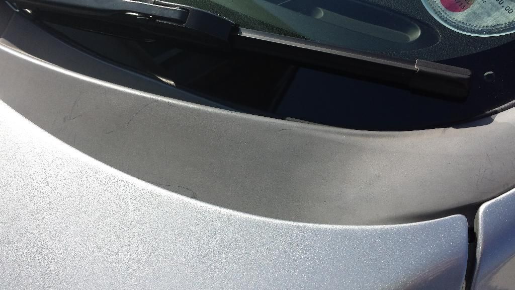

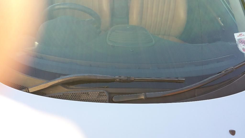

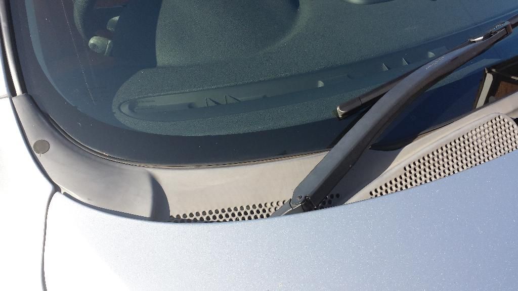

On the strength of this thread I bought some and today applied it to the Saab. I thought I'd share with you how it went and what I did.
As you can see from the first picture the plastic was really showing it's 7 years and had faded badly and showed evidence of previous wax etc. Having not used this product before I decided to mask the area's up that were being done ( I'm also a messy so and so lol ) The car had just had a really good wash but to be sure I cleaned all the area's with some surgical spirit first which pulled a load of muck off, and I thought the area's were clean lol. Next I applied the C4 and as everyone has previously stated a little really does go a long way, and instantly the results are there for you to see, it does exactly what it says on the tin and leaves a really classy finish when wiped over with a micro fibre cloth. I was surprised how mucky the pads were after applying the C4 it appears to really strip everything of the plastics. I then went round the window rubbers with some aerospace 303, wiped everything done and job done. In a nut shell very impressed with the cleaning power/finish of the product, time will tell on its life span and when it needs replying.
