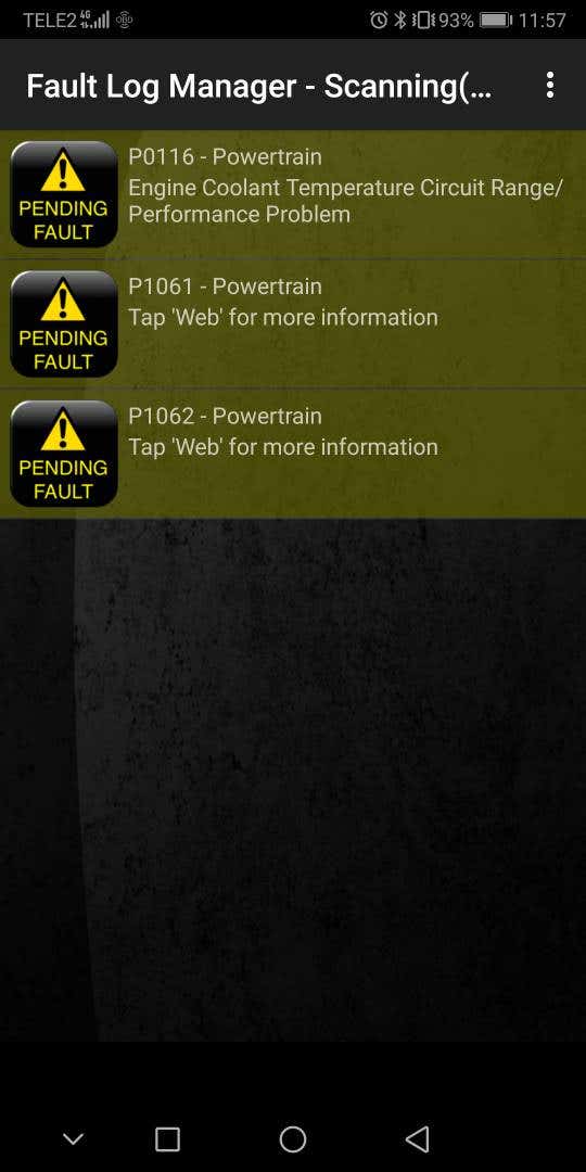

Here's the problem. Recently bought an Giulietta 1.4 170 tct, 2012, 85000km, everything was fine till I decided to change the oil, it was changed last year about this time and it has done 14000km since then. I used Castrol Magnatec 5w40 with Fiat's S2 specification as the manual suggests. Also I removed and cleaned the MA filter, it was completley clean and decided to reinstall it. After about 5km i got a ce light and start stop disabled. Got a mini heart attack. Limped home, cleared the fault (p1063) , a friend did a MA reset, (dont know the actual name of the procedure in MES) started her up and drove fine for about 80km yesterday. Today when I started her up, almost instantly i got the ce light and start stop disabled, also the car was running on 3 cyl. (screenshot of the faults below). Removed the MA filter again and noticed that the o ring on it is almost flat with the filter body. Replaced the o ring with a suitable one just to try it out because I can't get a new one till next week, if then. Started the car, rough idle again, but after a few minutes everything ok. Couldn't even hear the engine running. Cleared the faults, went for a ride, everything great.
Now, my question is: could a bad gasket on the filter be the cause of the problem, could the system lose pressure because of it?? Hoping that someone with better knowledge of the MA internals will know.

My G is a 2011 version. The attached photo shows the MA filter replaced as routine at 48,975 miles. The o-ring looks flattened but perhaps not as much as yours. The mechanic who did the work (Pud237 on here) gave the old filter to me and said that a wash in petrol and it could be reused if I wanted to save money next time it was changed. This was in 2016 when the belts and water pump were replaced. I had no multiair problems until 2018 when the engine would momentarily misfire and the engine management light came on and DNA was disabled. In-between the engine ran fine and drove ok except for the lack of DNA. A read of the fault codes indicated P1061-71 stored (rather than active) which is "cylinder 1 UNIAIR actuation electrovalve signal - Actuator stuck". I was advised the engine was ok to use but take care, do not drive it hard and if the problem got worse review the situation. To cut a long story short I had the multiair unit replaced as a confidence measure.
The whole story is detail here https://www.alfaowner.com/Forum/alfa-giulietta/1159586-help-error-message.html
I suspect that if you are getting both P1061 and P1062 codes then actuators on two cylinders are sticking but not necessarily at the same time as they show as pending not active. This might be due to a lack of pressure rather than mechanical sticking. If your suspicions are correct then you should have no further problems but my advice would be the same as was given to me. Take care, don't push it too hard and see how it goes.
