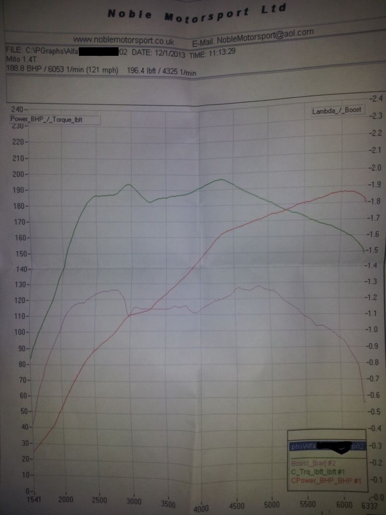

Put the mito on the dyno yesterday -
had the usual issue of not being able to get it to stay in dynamic mode - they even tried bypassing the ecu but it still kept kicking it into normal
so results in normal mode was 188.8 bhp and 196.4 lbft - very pleased with this as in dynamic must be looking at around 210 lbft?

#6 ·
Pull the ABS fuse out... You won't be able to engage dynamic then but at least traction control won't keep kicking in...
I had the Abarth SS on a Dyno and it made 136bhp at the wheels with TC kicking in. Was only told later to pull the ABS fuse... So will go back and try again..
More than decent figures for the MQV tho...
#7 ·
all system disengage after front wheels been rotating a minute anyway on the mito, so no need to pull any fuse or disconnect anything :) but then kicks it into normal which sucks .
thats why after he tried to go straight into ecu and bypass it , as soon as he went into it and disabled assist it still chucks it into normal.
so theres no real way to get it to do it in dynamic unless you can find a RR where all the rear rollers match the speed of front rollers ( do they exist? )
but yea decent figures anyway :D made a MK V R32 golf look silly ;)

#24 ·
Just had another dyno today since having sports cat n induction
it managed 191.8 bhp n 198.6 fblt (in normal again)
Had to take fuse out this time as it wouldnt disable anything, bloody car...
