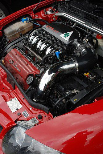

Just had the car's already modified mapping adjusted to account for the mods i did in the past year. Here it goes:
205wbhp:
-I have to scan the dyno chart as i only have it printed
-Car had only CF2 manifolds with equal length downpipes
226wbhp one:
-Full decat with CF2 manifolds, equal length downpipes and big silencer in place of secondary cats
-X-air sports air filter
-Cold air feed from feeding from front bumper
-Remap
240wbhp one, in addition to the above:
-Ferrari 360 throttle body
-ACT carbon plenum
-Crankcase ventilation removed from intake
-Tuned remap
Same dyno.

Pretty good gains with the plenum and 360tb then!! I need to get mine on the RR to find out what mine is since I've got her running properly :)
Need to sort out the air intake though as in struggling for air once you get into the upper reaches of the rev band :lol:

Bacon, what's your intake setup as I remember you saying you've got carbon plenum and big TB, you using a CDA? And could you take a pic or two how it's fitted etc please :)

As Fewleh mentioned, the 430tb requires a new intake pipe as the standard one won't fit over it, a new plenum too as it is wasted on the standard plenum and also a remap.
You'd be looking at around 1.5k at least to have it running spot on :)
#13 ·
the 360 just plugs right in and oem air intake will even fit over it (just about!).
the 430 is obviously bigger and someone else can tell you more about it, but think you need to get an intake hose that fits over it.. I think maybe the size means you more likely to need a remap and stuff to get it running right..? but someone with 430 can confirm this
