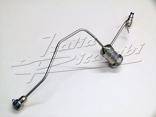

Having strange clutch pedal/feel issues on my 2.5 156, narrowed it down to the clutch damper as replaced everything else. After some searching it appears a few people have bypassed them (and the part is hard to find new). I can get some flexible lines made up but struggling with the union sizes i need. My measuring calipers are reading the threads are 11mm. Thats an odd size as most common are m10 and m12? The plan is to just route a line per the green line. Has anyone done this and can confirm?

The clutch damper is just to reduce speed of clutch movement to lessen the strain on the clutch if you release it too quick.
When I did the clutch hydraulics on my brother in law's 916 GTV I removed it and that improved clutch feel greatly.

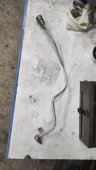

#20 ·
My valve and all connections are toast but still functional. I noticed this after removing the battery tray for the first time, have only had the car a few months (05 147TS).
I don't have the ability to service this at the moment by splicing in, but I can take it out and take it somewhere. Maybe the old fittings are salvageable-- is this the only way to proceed? I assume no hose can be purchased without the valve, which would fit both ends (some Alfa or Fiat part for example)?
Incidentally, when I saw this I thought oh great, some random rusted s* to replace, but as I've read up on the improvements (John Lear's AU thread notably), I'm seeing this as an opportunity for an unexpected upgrade!
