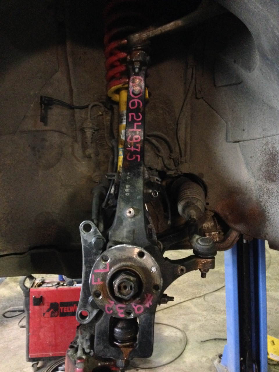

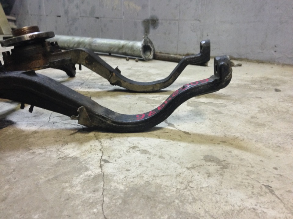

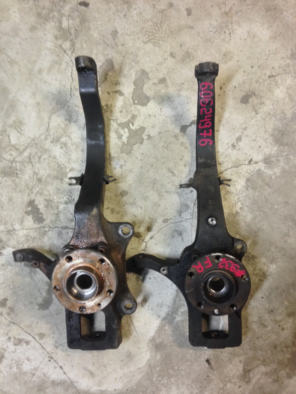

I have used the knuckles from Alfa Romeo 166 on my 156 as you did on your pictures, and also I have a point visible on your second photo where the pillar of the knuckle is hitting the strut mount on longer wheel run-up, like on deep road holes, speed bumpers, etc
Have you solved this problem?
I mean, it is very loud in my case, it is impossible to use the car on a longer run.

No 166 knuckles, original 147, no problem whatsoever
