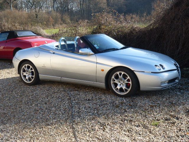

I had the spider out for a test drive yesterday, after a repair at the front of the engine. Everything was going fine there was a kind of metallic noise, like a spanner or something hitting the underneath of the car. I know this is probably off a tractor as I live next to a farm but will ask anyway. Could this bit be from a 2003 Alfa spider as its not going into gear with the engine running now.
