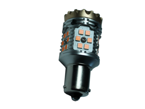

Heya, I've been on an LED bulb journey as well. For indicators, CANBUS error free ones I've found are:
Just make sure to order a double pack if you get it
In terms of brake lights, I've tested a fair few bulbs and had no luck whatsoever, I think installing resistors is unavoidable for these though I've yet to do that myself
Thanks for that! Will get a set to try out. I think I'm at the end of my LED journey. Quality is just too much of a hit and miss for me to experiment anymore. Maybe these turn signals will be my last set of LEDs for the 159.
