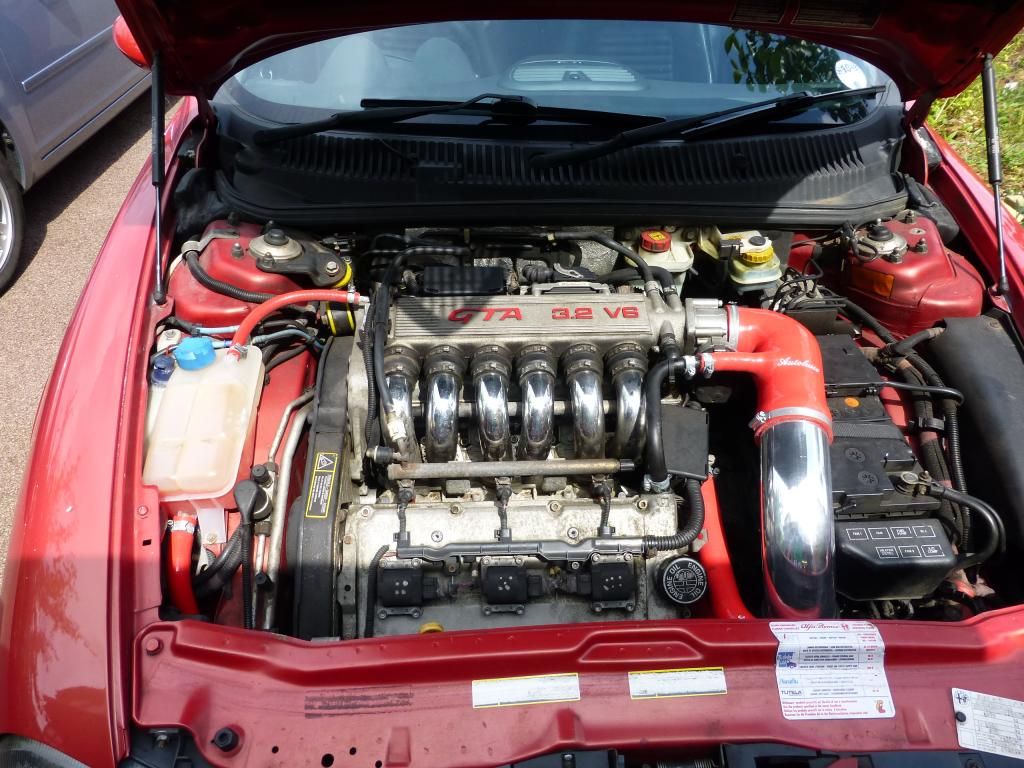

Why bother? Well, it was looking a bit manky and I felt the need to dismantle something.
The before
less the front coil cover.

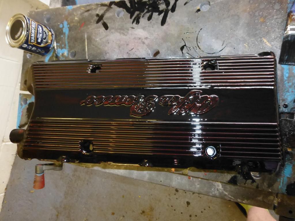

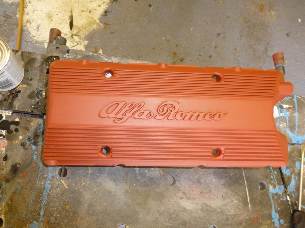

Then a coat of Hammerite special metals primer. This stuff is water based but gives a key to non-ferrous metal for the top coat.
First coat of Hammerite smooth black.

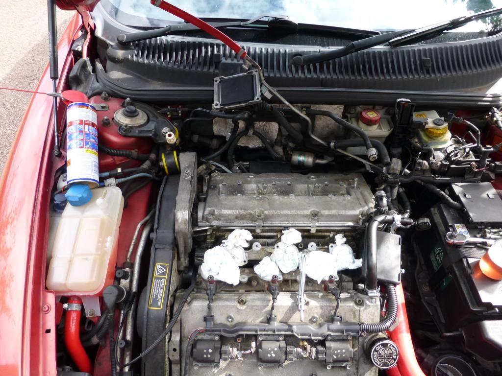

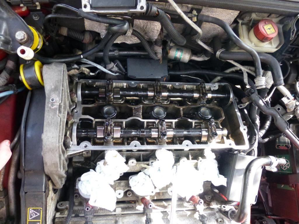

While that took its own sweet time to dry, off came the intake runners and the intake plenum, along with the throttle body, intake pipework, rear fuelk rail and injectors, front fuel rail and vent hoses from the camcovers.

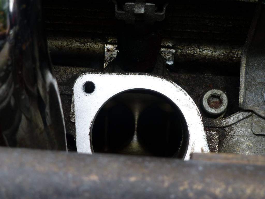

Why the kitchen roll stuffed in the holes? Well I am a cluts and I was sure to drop something down one of the open pipe holes, here you can see where it would have landed, that's the back of the intake valves!

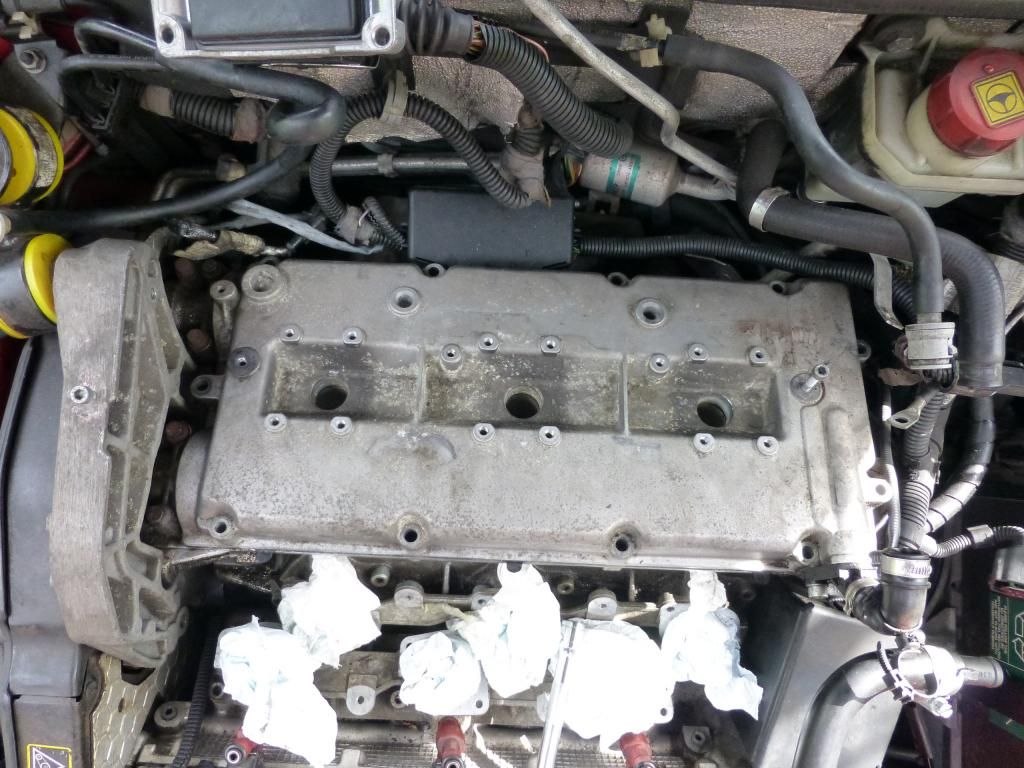

This pic shows that the aluminium is not in good shape, it is corroding quietly under a layer of muck and filth.
So, off the rear bank cam cover comes too. I found a small oil leak at the back of the rear cam cover that had decorated the rear part of the engine with oil. It turned out that a small piece of paper or thin card had got into the sealing gasket on the rear bank and had left just enough of an opening to allow a tiny bit of oil to dribble through.
Anyways, here is it without a rear bank cam cover

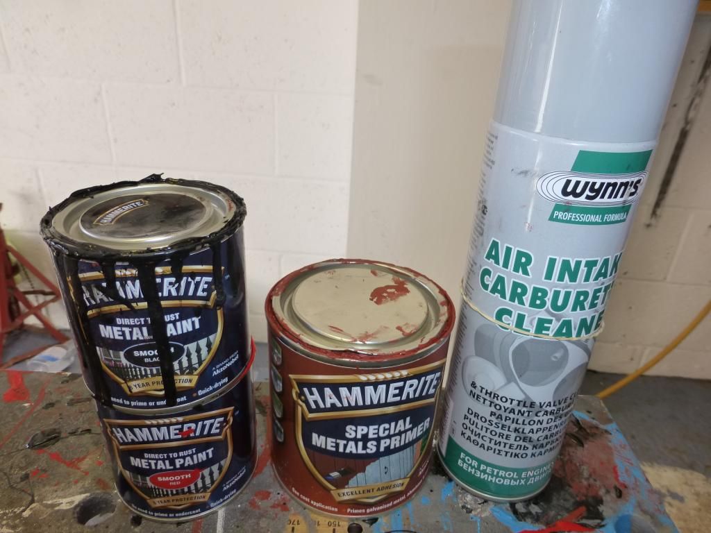

Here is the basic kit list

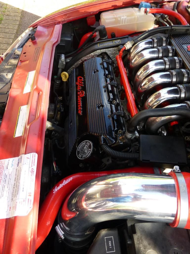

The hammerite smooth is good stuff, but needs two coats to fully cover the red undercoat. That said, where it is a little thin on sharp edges, you get a kind of red ghostly edge showing through which I quite liked.

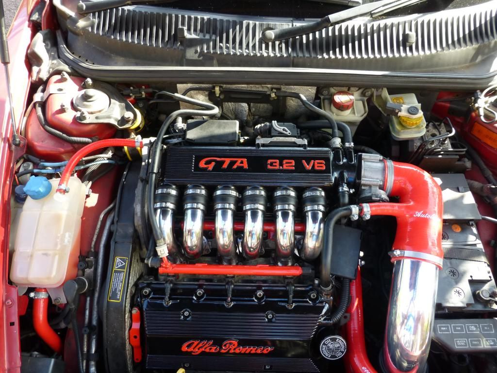

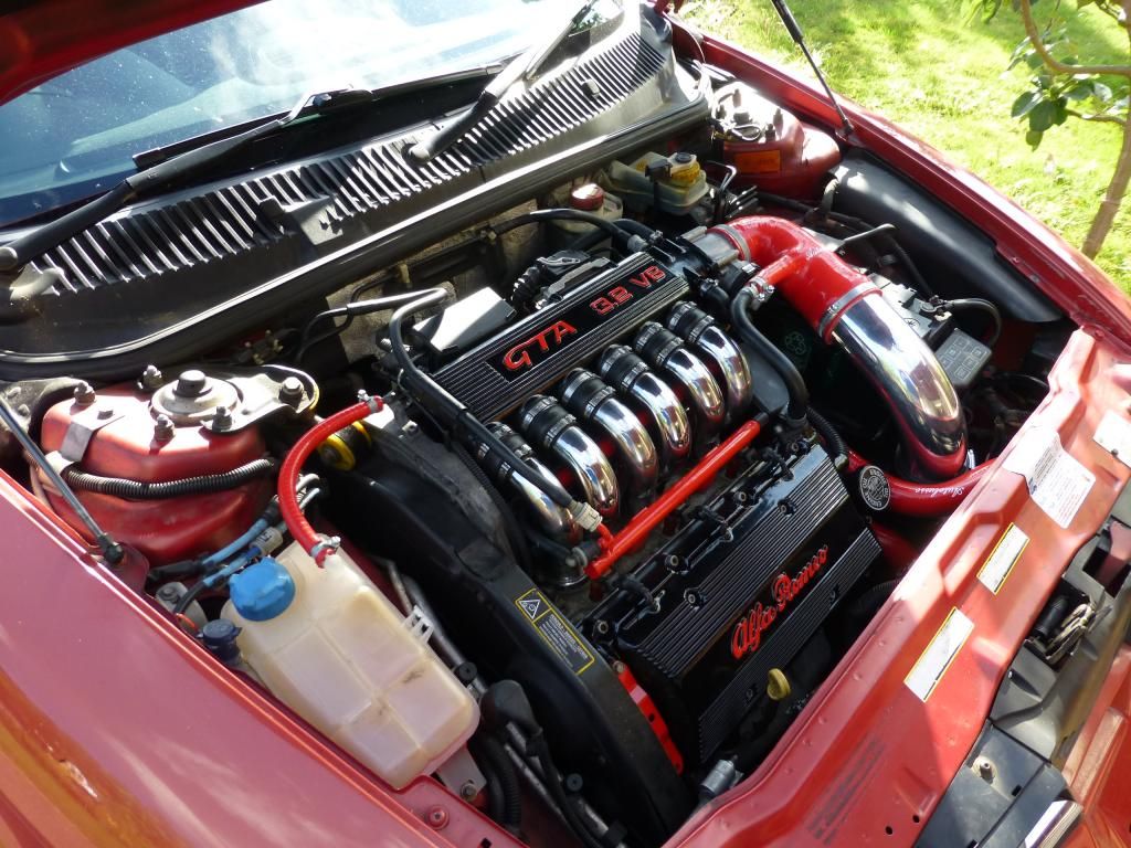

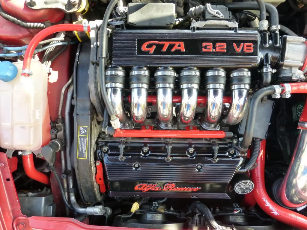

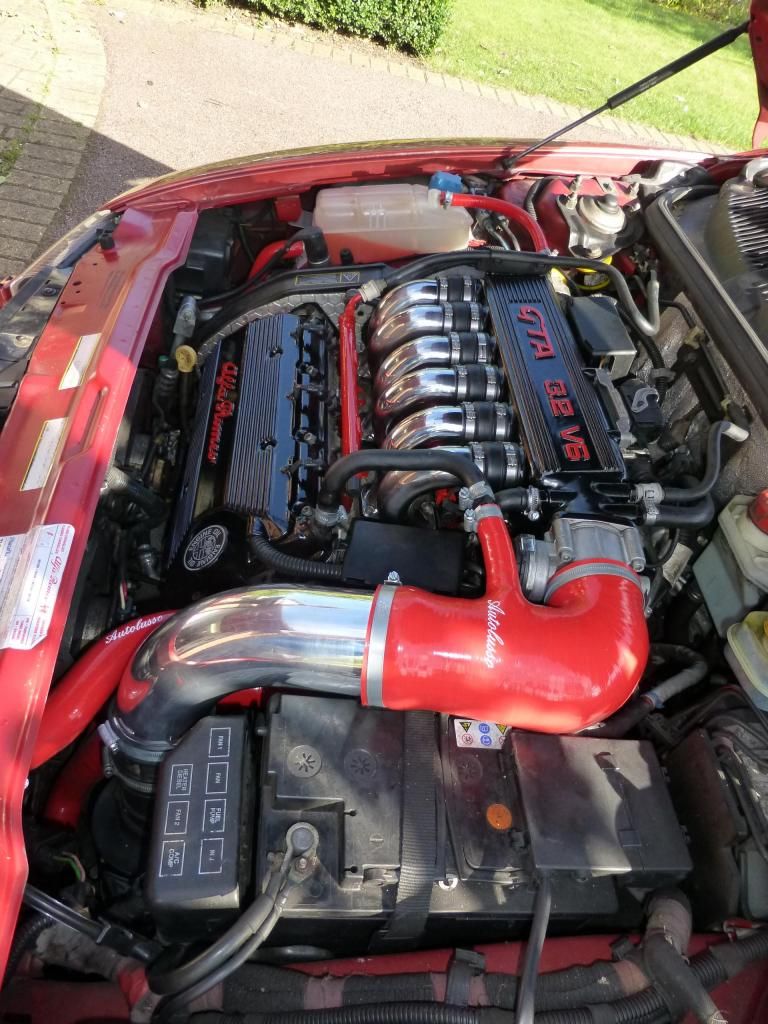

Here is the finished article.

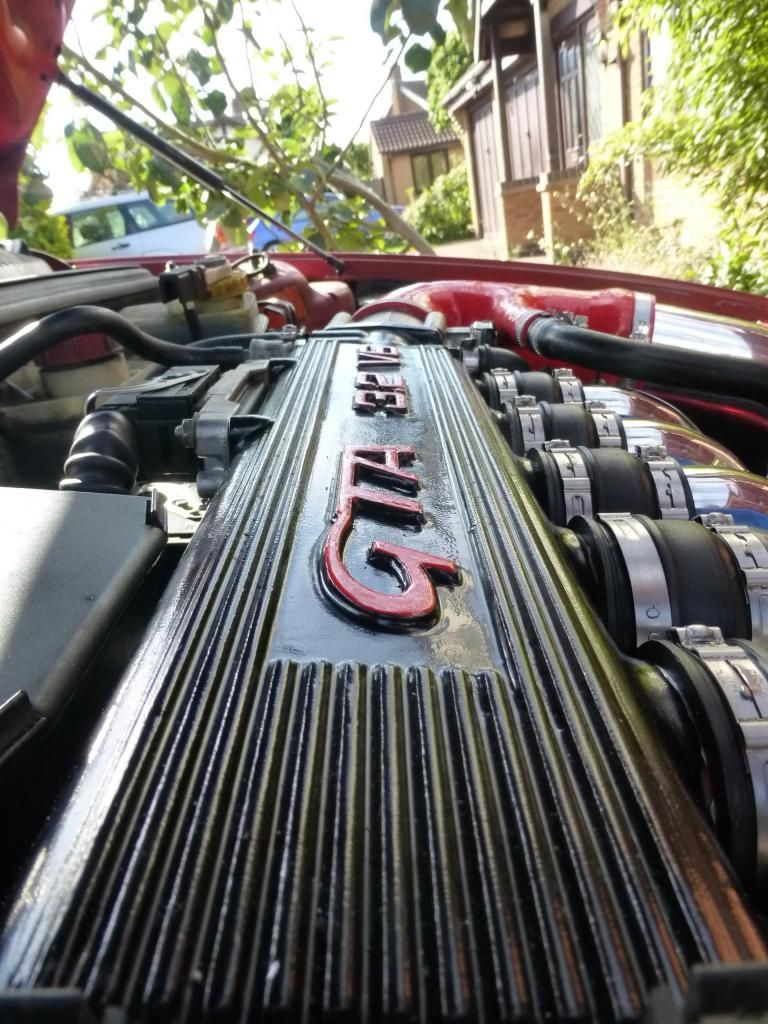

Both front and rear bank cam covers are just painted where they can be seen, the centre section where the coil packs fasten I haven't touched.
The fuel rails are red hammerite, again two coats and the fixing plate is also red because I happened to have a red hammerited brush to hand.
The chrome pipes still need more love, they have been buffed and polished but the rust and pitting are still noticeable.

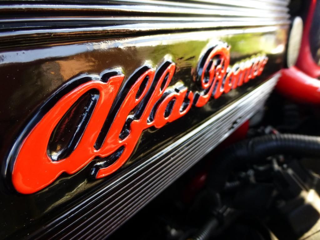

The Alfa Romeo script I painted by hand, it took 3 coats, and although not perfect, does the job well enough.
The total cost for the paint and the replacement gasket set that I needed was just over £100. Total; time was about 8 hours, mostly on removing and replacing parts.
