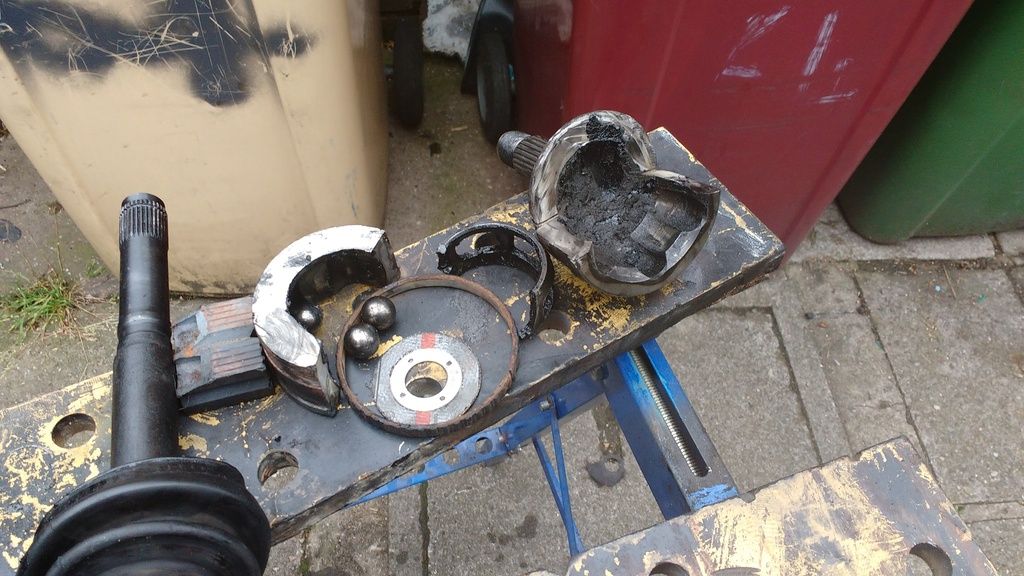

I digress. On to the cars, starting with the the CRV which continues to rattle along. Readers with long memories may recall some fun and games changing a CV joint, which tuned into changing a driveshaft. The clonking continued so I decided to change the nearside CV joint which I had in stock after buying one for t’other side. This time I decided that I would not be defeated by a CV joint that refused to be separated from the driveshaft. An economy size pack of cutting discs was purchased and the joint was using a not strictly by the book method.

Unhappy at such violent treatment, the rattling pile of crap decided to throw a major wobbly. It went all weird and felt like all of the drive was going to the rear wheels causing massive drivetrain shunt. This had me and the Honda specialist completely stumped. I removed the propshaft to isolate the problem, the theory being if it still felt like ****, the problem was the front, if it recovered, it was the rear. As it happened, with no centre prop, there was no drive at all (which shouldn't be the case on a CRV). I initially suspected the gearbox but, after further dismantling, I found this:
The (pattern) driveshaft snap ring isn't strong enough to hold it in the box. It worked its way out as fa as it could, ran around like that for a while, then stripped the spline. Thankfully, the spline in the box was unharmed and a 2nd hand shaft had it up and running in no time.

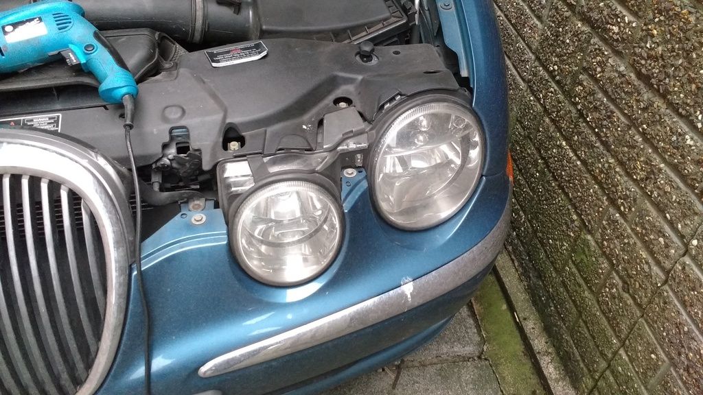

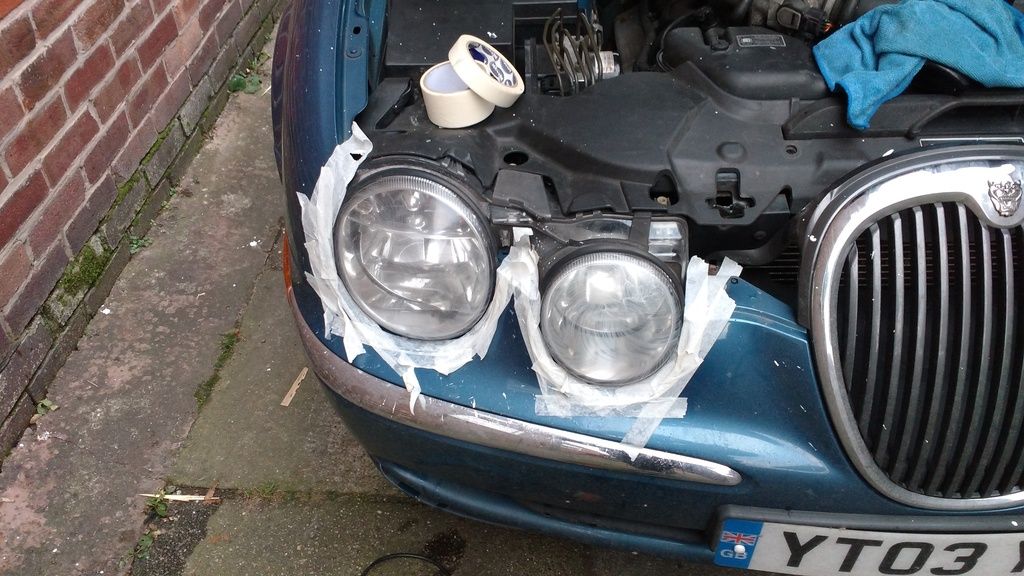

And so to the Jag, which has been surprisingly trouble free. One problem it came with, which affects all modern cars with plastic headlamps, is dull lenses like this:

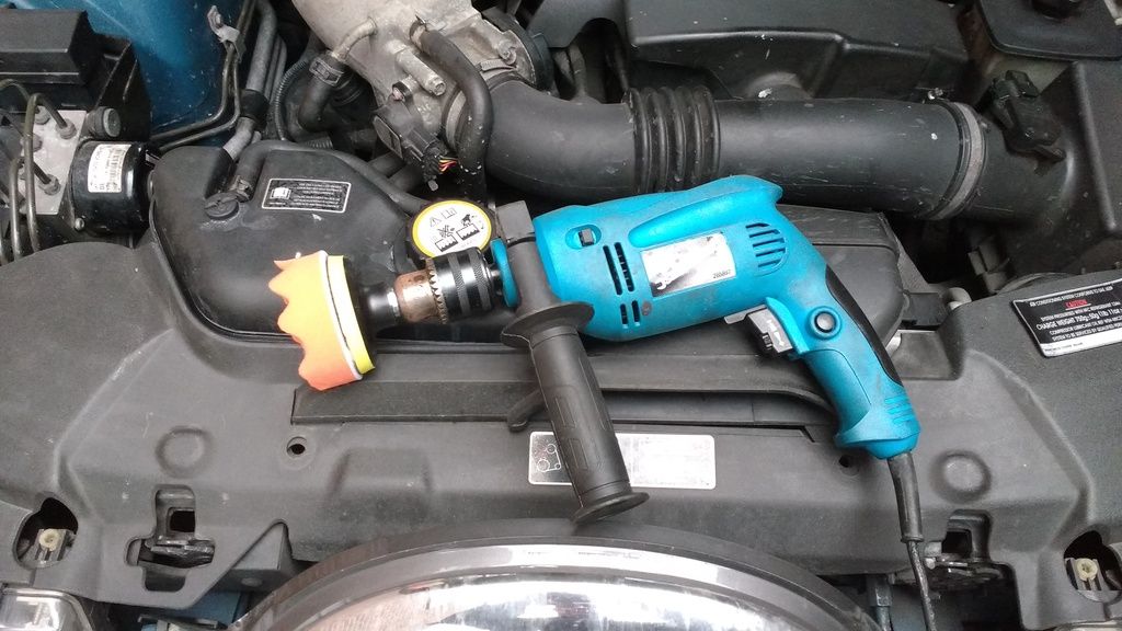

Polishing them is hard going, even with this:

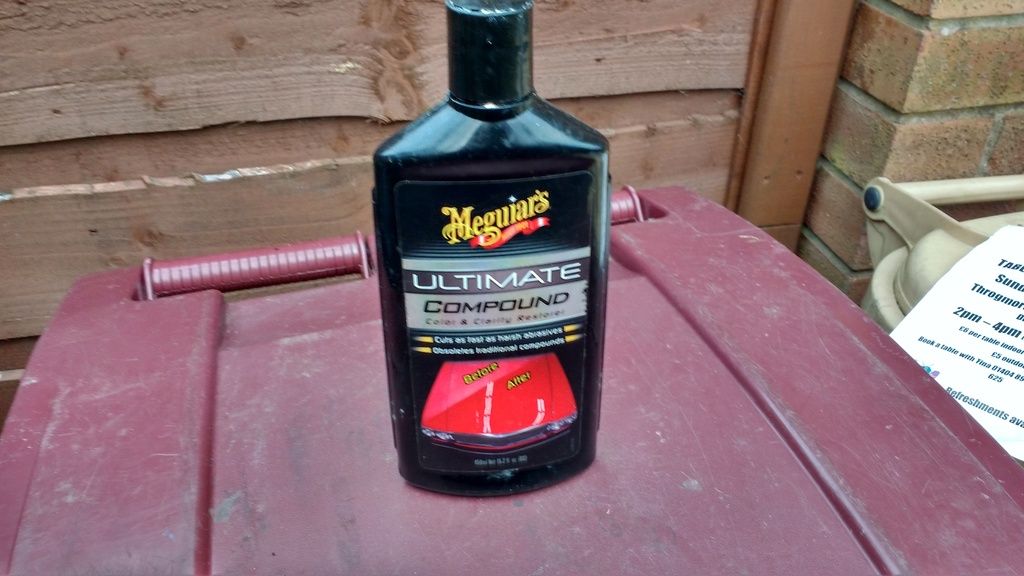

The answer, according to the interweb, is to wet sand them and buff them so I gave it a go.
After 800, 1000 & 2000 grit, I set to with my £3 ebay polishing pads.

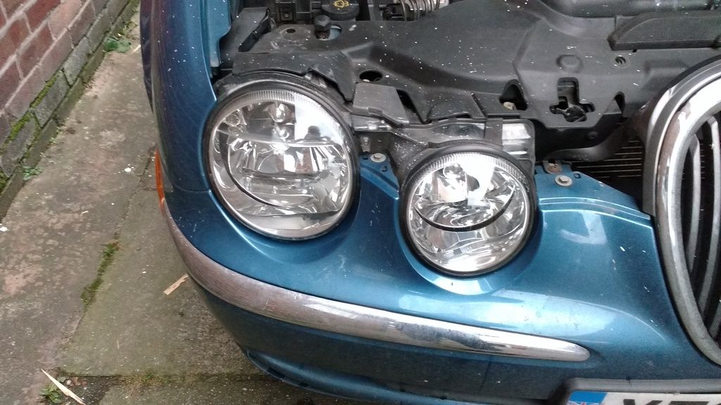

The results, after covering the whole car in compound, still look crap in the pictures. They are much clearer in reality.
After polishing, I sealed them using Autosmart's excellent Topaz sealer polish stuff.
