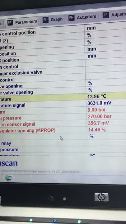

Finally got back to trying to figure out what is wrong with my wife’s 159 2.0 jtdm
1 reading
4.5K views 60 replies 16 participants last post by  R.T.
Still having non starting issues with my wife’s 2009 159ti 2.0jtdm!.
This is how the story goes.....
Car was stalling whilst in traffic and whilst slowing down.
Then one day it just refused to start at all!.
So..... I replaced the crank sensor with a brand new Bosch one..no change.
Couldn’t hear the in tank fuel pump priming so checked fuses and relays,all were good,so pulled out the pump,hooked it up to 12v,nothing!!.
Yeeeeah I thought there’s the problem.
Bought a brand new Bosch pump,stuck it in,put new connectors on the fuel lines,one way valves,new fuel lines,ignition on and off it went priming and bled it up to the brand new fuel filter.
Still won’t start?!!.
Stuck it on diagnostics and got (what you see in the video) back?.
Tried a new Bosch high pressure pump on it....no change!!.
Four brand new Bosch injectors....no change!!.
New Bosch fuel pressure sensor...no change!!.
New cam sensor....no change! .
New Bosch glow plugs and control module.....no change!.
New Bosch MAF....no change!
New injector leak off pipes and the plastic thingy that sits near the hp pump.....no change!
It’s also had a brand new Bosch hd battery,brand new egr valve,all new fuses and relays,every earth point has been ground back.
I even sent the ECU off for testing and that came back with no faults?.
The car WILL start with a little squirt of easy start,it will drive 100% perfect with zero smoke or drama.
As soon as it’s turned off.....it’s back to not starting!!!??? .
Now as you can see by the video footage of the multiscan the rail pressure exceeds the requirements for it to start briefly but then plummets.
There are no leaks anywhere,all connections are tight!!.
I’ve tried three different rail pressure sensors.....all read the same ??
I genuinely haven’t got a clue now??

Engine turns over like the clappers!,but still on multiscan the rail pressure goes above and beyond the pressure needed to fire up,but then drops as fast as it goes up?.(see video)

Rpm high enough to start? You need 250 rpm minimum. The easy start could be pushing you over.
RPM over 250
Fuel pressure over 300
Battery voltage over 10V while cranking, ideally
No mismatch in crank/cam timing
Then the car should start.

Are you getting any smoke out the back? (i.e the injectors are firing) Are the injectors getting a signal (what is the correction values for them?), IIRC there was a common issues with the injector loom, especially on the 2.4 engine.
Also check the signal to the low presure pump, it runs through the fuse box by the drivers knee, has a connection, then to the boot. Number of people (including myself) have had issues with it.

Your electrician also stated that no fuel was coming out of the injectors, can you check that they are getting a signal? find it odd that the engine is not even stuttering when starting if you are meeting the right parameters.

I'm just going to spitball some ideas here so please ignore any that you've already looked at. (Or are just dumb!)
To me the high pressure and it not even sounding like it wants to start suggest none firing injectors.
Have you taken the injectors out and tested they are actually supplying fuel on start up?(The old take out of the cylinder head and spray into a cup job.) If they're new then they should have a good spray but if not then there's clearly an issue between them and the ecu.
Do you get any smoke when it does eventually start? If not this suggests that the injectors aren't firing when cranking. If you do then there is either not enough heat, air or compression
Compression issue that 'fixes' itself when the cylinder is warmed (and thus bits expand) by the cranking?
Failed head gasket?
Air lock in the fuel system?
Water in the fuel system?
Drained fuel and tried with fresh?
Worn cam?
Taken off the induction piping and tried starting without all the guffins attached?
Double checked all the other new bits fitted in the correct manner? (I know, but sometimes it's the dumbest things)
These are just things that it could be and random ideas I've had that you could try.
As it stands you're faced with a choice of throwing more money at it or cutting your losses.

Imho the fuel pressure drops when the injectors start to deliver. Stalling also points in this direction.
I had a similiar problem with an older jtd, there it was the above mentioned pressure pump control valve. Ok, yours is new, but it acts like the pump before, right? Have you considered residues / particles in the fuel system that clog the valve? Maybe the dying lp pump chucked some debris into the fuel circuit. Try to flush it. I did it using a tubesized magnet (the ones, that are attached to power chords) on the fuel exiting fuel line. Found a fair amount of metal particles.

OK, having re-read your original post, you had issues, changed huge amounts of things, final thing being the starter motor - and after that was changed, the car started OK and you drove it most of the way home before it cut out again.I think that's a summary. Not sure, but whilst it sounds like the car would run OK once started on Easy start before the starter motor was changed, you aren't clear on whether that is still the case.
It sounds to me like two issues - one the starter motor or possibly its wiring, and two, whatever is causing the engine management light to come on and perhaps cause the stalling. Starter issue may be solved, so we need to establish what caused the engine management light - it could just be sticky turbo vanes after a prolonged period of non-use, but without the fault code being read we can't be sure. Otherwise almost certainly an electrical fault, possibly an internal wiring break/short - my initial thought was that it was perhaps linked to the start/stop switch, and I would have suggested triggering the starter motor remotely to see if the car would start then, in case the start button was simultaneously triggering the starter and killing the engine - I'm not entirely sure how the stop circuitry works. If the car will still start on easy-start and then run, it might still be worth trying to bypass the starter switch.......
#32 ·
When you replaced the LP pump you fixed a definite fault, so it should have started, but didn’t. What had changed in the meantime was the crank sensor: so I would first check that the new sensor is seated correctly, so the distance from it to the phonic wheel is correct, and that its connections are clean, and then put the old one back in.
[Everything you do to increase the cranking speed: new starter, easy start helps starting. This points to a weak crank signal.]
[If this is correct, the pressure collapse is a symptom not the cause.]
There are no leaks anywhere!!.
