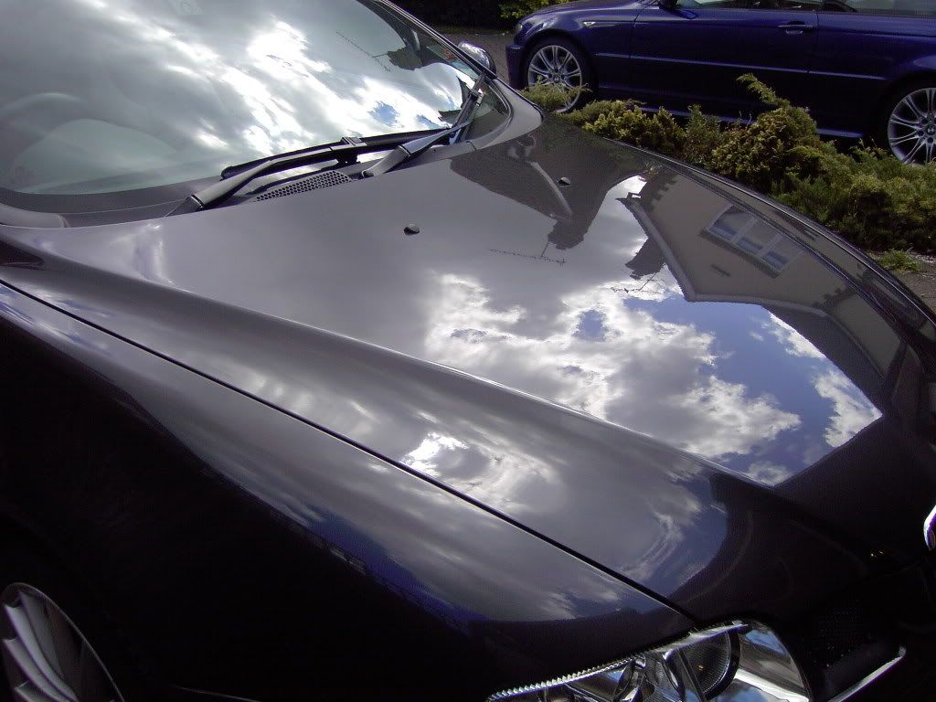

Hi guys,
After my previous post about snow foaming & foam lances, etc, I said I'd try to post up some pics of my efforts.
Just to be clear, I'm NO car detailer. Job, 3 kids, dog, blah blah blah.
So I'm not going in for "concours" level quality.
I wanted a quick & gentle way to keep my bella looking good before my next commute on the M25.
I bought some BH anto-foam & an Autobrite foam lance to use on my Karcher. Chemguy was a great help in explaining what was what to a newbie like me.
So, how did it go?
Well, 1st I cleaned the wheels, using AG wheel wash.
Here's how it looked before I started. Not really dirty, just about a week or so of road/rain stains.
Then, I gently rinsed the car, & then with about 1" of snow foam mixed with 1ltr of warm water in the lance, I got foaming!
It didn't foam quite as much as I thought it would. It didn't look like shaving foam, like some of the youtube clips I've seen.
I let the foam stay on for about 4 or 5 mins, but it was fairly sunny & it seemed to be drying pretty quickly. So, a gentle jet-wash rinse & repeat, again leaving it on for 4 or 5 minutes max.
Rinsed it off & then whilst wet I applied a quick wipe over with AG Aqua wax using the supplied MF towel.
Pretty quick & very easy.
The results??
Here you go...........................................
Yep, pretty happy with that. Even on a sunny day with a dark coloured car, I think the results are pretty good. I wanted to see if it really worked, so I purposely didn't hand wash the car at all, just to see if the snow foam really does lift away the dirt as advertised.
I think if I really gave the car a good few hours work, adding in a hand wash & proper waxing the results would really look superb.
So yes, it seems to do what it claims. A clean car for very little time/effort & not using a wash-mitt or sponge etc should help keep the paint in better nick for the long term.
As I said, I'm not trying to compete or show off my detailing skills here. I'm a real newbie to all this lark. I just want to find something to keep my GT looking as it should without spending hours & hours on it.
Having said that, whats all this "claying" malarky about?
Matt.

This could be "controversial" so lets see what everyone else says, but IMHO you should not rely on the snowfoam to lift off the dirt completely. It is only supposed to soften and help to prepare the surface for a normal wash with a mit and two buckets etc.
I think you are running the risk of inducing swirls on the beautiful dark paintwork by snowfoaming and then going straight to the aquawax. You might rub specs of dirt across the surface.

Springbok. I appreciate what you say, but before & as I aquawaxed, I was looking very closely for any residual dirt. It was thoroughly rinsed before waxing & very light pressure applied with minimal buffing.
This method for me is probably a one-off, just to see what snow foam did on its own, with no other cleaning processes to exagerate its effectiveness. In future, I'll definitely snow foam, but probably use it as a quick wash with no waxing afterwards, or as a pre-wash, as a 1st step in cleaning my car.
Thanks for the concern. You are probably right to point it out.
