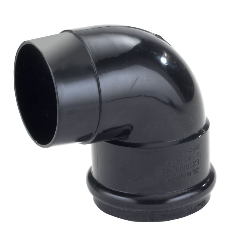

so for a cold air feed for my intake....
just wondering:
-What kind of piping should i use? Hard plastic or bendable/jointed/flexible piping?*
-Should i run the cold air feed up to the current intake or cut a hole in the airbox and feed it into there?
-where's the best place to locate the "cold air"/intake end of the feeder pipe?
-Any other advice ya wanna give me?
*solid/hard plastic pipe:
http://s7ondemand4.scene7.com/is/ima...001c_v001_ap?&
*flexible piping (without filter end):
http://washford.scene7.com/is/image/.../539379?$prod$
thanks in advance,
Phil

The material doesnt really matter to be honest, you can buy tubing with attractive funnels at both ends from places like halfords or ESP Design - Car Air Filters, Brakes, Suspension & Top Quality Exhausts - ESP Design Ltd
I woldn't bother cutting the plastic if your just using the OE factory airbox
As for location Id say as close to the front of the car as possibe maybe behind a grill or somewhere like that.
