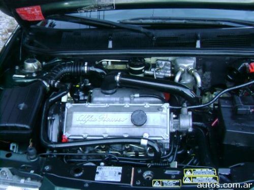

The engine is the knowed ( in italy-Spain) 1929cc fiat-alfa-lancia turbodiesel, it have no electronics, mechanical diesel pump, 8valves, 1 camshaft, simple turbocharger ( not variable geometry), and throttle cable to the diesel pump.
I like that engine cause it's all top head in alloy ( i never see any diesel engine in alloy, and the Alfa Romeo letters in the alloy)
Cause it not have ECU i adjust myself the parameters, the disel pump have adjust with his pulley ( to advance the injection or delay the injection time) and the turbocharger, have the adjustable rod, to make hard the lung of the valve and make the waste free the overpressure too late or more soon)
My answer is wich turbocharger is more bigger and plug&play with my actual turbocharger mounting?
The only 155 diesel engines was the 1.9 ( commercial named as 2.0TD) 90hp, later 92.
And the 2.5 4cylinder with electronics, 125hp ( chipping and 168hp i see on the net)
http://www.autos.com.ar/fotos/2011/0...4251010140.jpg
Here a pic of the engine.
